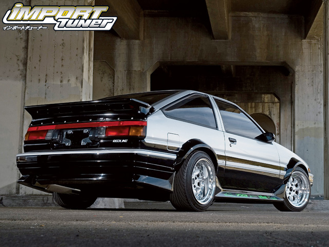

Official Modifications List:
Engine & Drivetrain:
Factory Hi-comp, small port 4AGE (slightly “massaged” intake & head  )
Pair of Mikuni 44PHH carburetors
278° cams from Colt Cams
Megajolt Lite Jr. for programmable ignition by AUTOSPORTLABS & a set of 1mzfe COPs for delivery
NST adjustable cam gears, custom fitted trigger wheel crank pulley & alt pulley
NST radiator shroud
OBX headers
Straight pipe
Buddy Club Spec II catback
Competition Clutch housing w/ Exedy clutch plate
Factory T50 5spd spinning a full spool by Predator Racing
Suspension & Chassis:
-Front-
Custom front coilover conversion w/ AGX shock cartridges (SW20)
Springs: QA1 450lbs
NST/DME upper strut bar
NST mbc stopper
T3 camber plates w/ hats & adjustable tension arms
Whiteline adj. front swaybar
Custom front bomber bar
Full manual rack conversion w/ power steering knuckles
Battle Version inner tie rod kit & NCRCAs
Cusco engine & trans mounts
All under a Seibon drop vent cf hood
-Rear-
Floor bar
Custom trunk/carriage bar
QA1 12way adjustable rear coilovers
Springs: QA1 350lbs
Whiteline adj. rear swaybar
Adjustable Panhard & 4 links
Custom traction brackets
All under a Cusco frp hatch cover
Aero:
JBlood style frp front bumper and rear bumper add-ons & TRD style frp hatch wing by Shine Auto Project
CBY style side steps by P.A.S.S. Racing
Rolling around on a set of 14” x 7” Konig Rewinds
